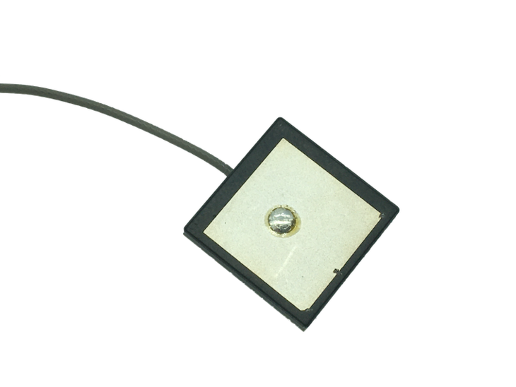

    I’m not seeing the map show up on nrfcloud.com but it makes sense that the antenna does not support it.
    Is there an antenna that will work with both LTE and Active GPS for this microcontroller?
    Or is there a way we can have the LTE antenna and the Active GPS Antenna both connected to the device?

      occurrentarts Is there an antenna that will work with both LTE and Active GPS for this microcontroller?
      You need two antennas. One for LTE and one for GPS. The hardware does not support combining the two together unfortunately.

      Hey Jared,
      We’ll try to source a GPS antenna then and see how it works.
