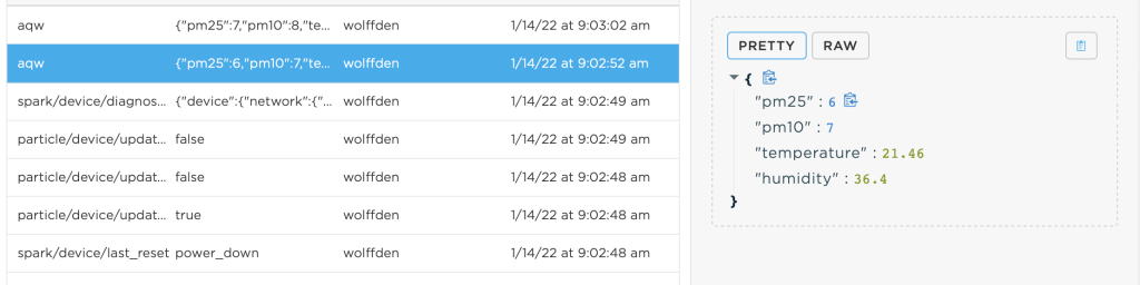

I did take an Argon out of service to try it on my end. It took about 4 minutes to fully update everything including the app.
![](https://community.jaredwolff.com/assets/files/2022-01-14/1642169031-996428-screen-shot-2022-01-14-at-90305-am.png)
