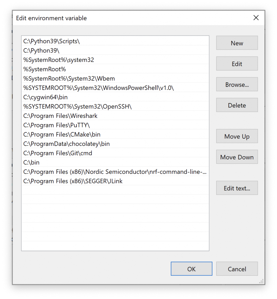

            Also @SteveD0 not sure if you noticed but when installing Nordic’s Command Line Tools jlink.exe doesn’t get added to the $PATH. I had to do it manually. Not sure if that was your experience.
            I updated the documentation here.
