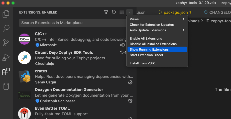

        JeppeMariagerLam the .zephyrtools directory gets generated by the VScode plugin. Since currently there is no support for aarch64 it won’t copy any files. I’m working on M1 support as I write this and will have an update pushed to the VSCode marketplace once I’m done doing some testing.
        Not sure it’s working Jared. Just tried to do a fresh install of VScode and the extension running v. 0.1.28, but when I run Zephyr Tools: Setup, I get “Unsupported architecture for Zephyr Tools” 🙁
        Or install it from the extension menu using the “Install from VSIX” option. When I publish the final one it will override this one. (If all goes well of course!)
        That’s fantastic. Did you compile and use newtmgr or are you using an external programmer?
