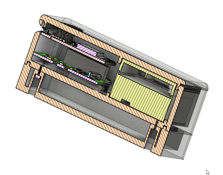

        • Will the AQW V6 board plus Particle board and Honeywell sensor all fit in your AQW enclosure? If so, then I can get a couple of AQW enclosures 3D printed.

          zpm1066 Will the AQW V6 board plus Particle board and Honeywell sensor all fit in your AQW enclosure? If so, then I can get a couple of AQW enclosures 3D printed.
          Yep they do fit. The enclosure below has both an AQW, and Xenon from what I remember. (Bottom compartment is for a rectangular LiPoly cell)

            Wonderful! All sounds good. I might be able to get a 3D print of the enclosure done through the local library this coming weekend.
