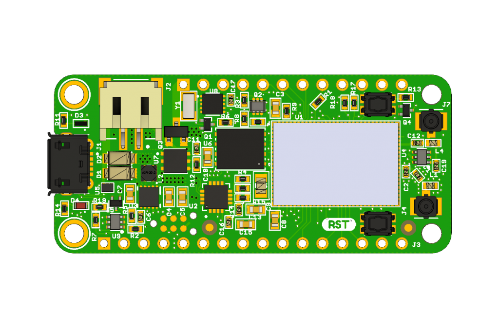

    Ill post things up here as I run into issues or suggestions, first off, after I put the headers on (pointing down so the match with the feather board that I have) the pin numbers are now not so easy to read. It does not look like there is much room on top for the pins on the silkscreen, but something like this might be nice to have in the documentation.
    https://cdn-learn.adafruit.com/assets/assets/000/046/244/original/adafruit_products_Feather_M0_Basic_Proto_v2.2-1.png?1504885373
    The first thing I need to do is route the UART signals to the correct GPIO pins, and for that I will need to know which ones they are, a diagram like above (sorry if it exists and I missed it) would be really great!

                    I am using the following two pins for UART2 communication and here is the routing that I discovered.
                    The GPIO numbers appear to refer to the actual GPIO numbers on the MCU, so P0.03 is 3, etc, and it appears to be a little different than the silkscreen numbers.
                    Here is the pin mapping from the overlay file (circuitdojo_feather_nrf9160ns.overlay):
                    &uart1 {
                    	status = "okay";
                    	current-speed = <115200>;
                    	tx-pin = <0>;
                    	rx-pin = <2>;
                    &uart2 {
                    	compatible = "nordic,nrf-uarte";
                    	//current-speed = <921600>;
                    	// for CTS  RTS support
                    	tx-pin = <4>;
                    	rx-pin = <2>;
                    	rts-pin = <3>;
                    	cts-pin = <0>;
                    	hw-flow-control;
                    	// without CTS RTS support
                    	tx-pin = <3>; // Feather nRF9160 D7 (as marked on the silkscreen)
                    	rx-pin = <1>; // Feather nRF9160 D5 (as marked on the silkscreen)
                    This appears to follow the Actinius Icarus, however I never was able to find the schematics for the Icarus. Something that I would like to have if anyone knows where to get them. I can’t find it on their website, is it buried?
