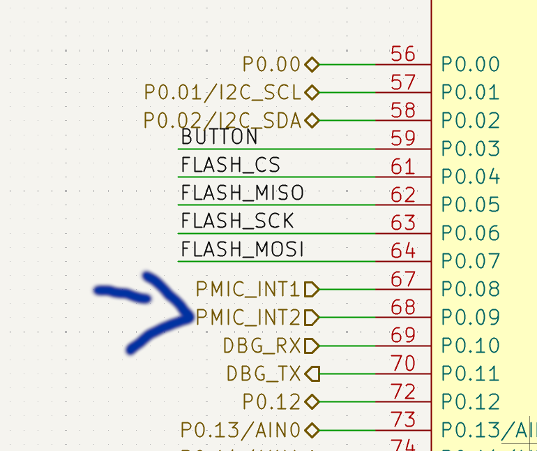

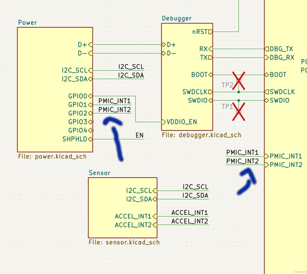

Is the hw enabled to get notified when the USB is plugged in and out?
If I remember well, this wasn’t the case for the nRF9161 prototype.
@AchimKraus I fixed it per your feedback. GPIO1 and GPIO2 are connected to P0.08 and P0.09 respectively.
