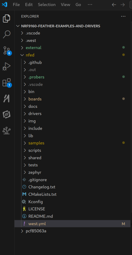

Also, your project should look something like this:
You may have to re-open one level higher to include the .west folder in order to parse the sub-directories correctly. (All board files for the nRF9151 are located in nfed/boards and the nfed/zephyr/module.yml tells Zephyr to look there in order for it to show up and be a buildable target

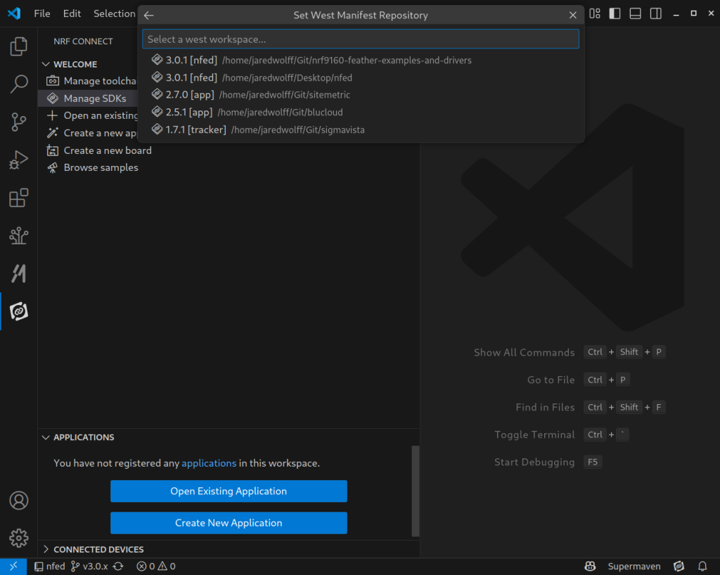

It’s probably related to having multiple toolchains/SDKs installed.
Try this command and make sure the folder you did your init and update in is targeted:
As you can see I had multiple entries.
Also make sure you have the base directory open in VSCode. So if everything is in C:\dojo\ make sure VSCode is open in that directory. (It should be the same directory as the .west folder)

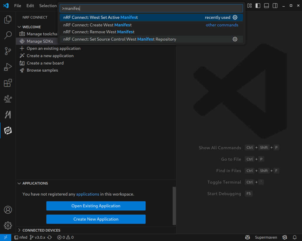

Going to nRF Connect: Set Active West Manifest, C:\nfed\nfed\west.yml is already selected and selecting it has no effect. Selecting C:\nfed\external\nrf\west.yml causes boards to appear in the list but that is wrong and causes the directory structure to be incorrect
My directory structure is
C:\nfed.vscode
C:\nfed.west
C:\nfed\external
C:\nfed\nfed
C:\nfed\nfed\samples\ etc
C:\nfed\pcf85063a

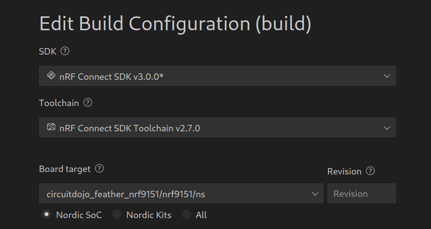

@jcd i’m sorry this seems like a bug/edge case with Nordic’s plugin. I was able to reproduce this and it appears to have to do with the directory structure. If you delete the external folder, and edit your west.yml to remove:
        path-prefix: external
Under the nrf entry and run the nRF Connect: West Update. Then select an application (I tried blinky) and create a configuration that should 🤞 do the trick.
That was it! All sorted now - boards appear and managed to Add Build Configuration and build Blinky sample. Flashed it using probe-rs. So all up and running now 🙂 Thanks again
