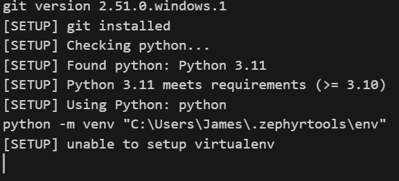

Howdy, I installed python 3.13.7 and then went through the init repo, when I go to do build or pristine build I get Could NOT find Dtc (missing: DTC) (Required is at least version “1.4.6”) as my main issue. I added C:\Users\James\AppData\Local\Microsoft\WinGet\Packages\oss-winget.dtc_Microsoft.Winget.Source_8wekyb3d8bbwe\usr\bin to my enviromental variables path I reinstalled nrf DeviceTree but after I had reininitialized the repo.
There’s another thread with a similar thread where the fix was re init the repo without spaces in the path.
