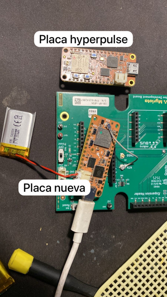

Hello CircuitDojo community, I bought 12 Feather NRF9151 boards from Digikey.
I’m using Myriota’s service (HyperPulse) to access the NTN service. The problem I’m having is when I load the sample firmware onto the new boards I bought from Digikey, not the ones Myriota sold me.
I’ve attached images to see if I’ve configured something incorrectly.

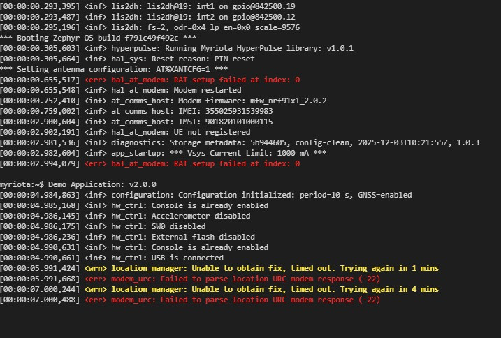

[00:00:00.655,517] <err> hal_at_modem: RAT setup failed at index: 0
this is the USB serial:
[00:00:00.293,395] <inf> lis2dh: lis2dh@19: int1 on gpio@842500.19
[00:00:00.293,487] <inf> lis2dh: lis2dh@19: int2 on gpio@842500.12
[00:00:00.295,196] <inf> lis2dh: fs=2, odr=0×4 lp_en=0×0 scale=9576
*** Booting Zephyr OS build f791c49f492c ***
[00:00:00.305,603] <inf> hyperpulse: Running Myriota HyperPulse library: v1.0.1
[00:00:00.305,664] <inf> hal_sys: Reset reason: PIN reset
*** Setting antenna configuration: AT%XANTCFG=1 ***
[00:00:00.655,548] <inf> hal_at_modem: Modem restarted
[00:00:00.752,410] <inf> at_comms_host: Modem firmware: mfw_nrf91×1_2.0.2
[00:00:00.759,002] <inf> at_comms_host: IMEI: 355025931539983
[00:00:02.900,604] <inf> at_comms_host: IMSI: 901820101000115
[00:00:02.902,191] <inf> hal_at_modem: UE not registered
[00:00:02.981,536] <inf> diagnostics: Storage metadata: 5b944605, config-clean, 2025-12-03T10:21:55Z, 1.0.3
[00:00:02.982,604] <inf> app_startup: *** Vsys Current Limit: 1000 mA ***
[00:00:02.994,079] <err> hal_at_modem: RAT setup failed at index: 0
myriota:~$ Demo Application: v2.0.0
[00:00:04.984,863] <inf> configuration: Configuration initialized: period=10 s, GNSS=enabled
[00:00:04.985,168] <inf> hw_ctrl: Console is already enabled
[00:00:04.986,145] <inf> hw_ctrl: Accelerometer disabled
[00:00:04.986,175] <inf> hw_ctrl: SW0 disabled
[00:00:04.986,236] <inf> hw_ctrl: External flash disabled
[00:00:04.990,631] <inf> hw_ctrl: Console is already enabled
[00:00:04.990,661] <inf> hw_ctrl: USB is connected
[00:00:05.991,424] <wrn> location_manager: Unable to obtain fix, timed out. Trying again in 1 mins
[00:00:05.991,668] <err> modem_urc: Failed to parse location URC modem response (-22)
[00:00:07.000,244] <wrn> location_manager: Unable to obtain fix, timed out. Trying again in 4 mins
