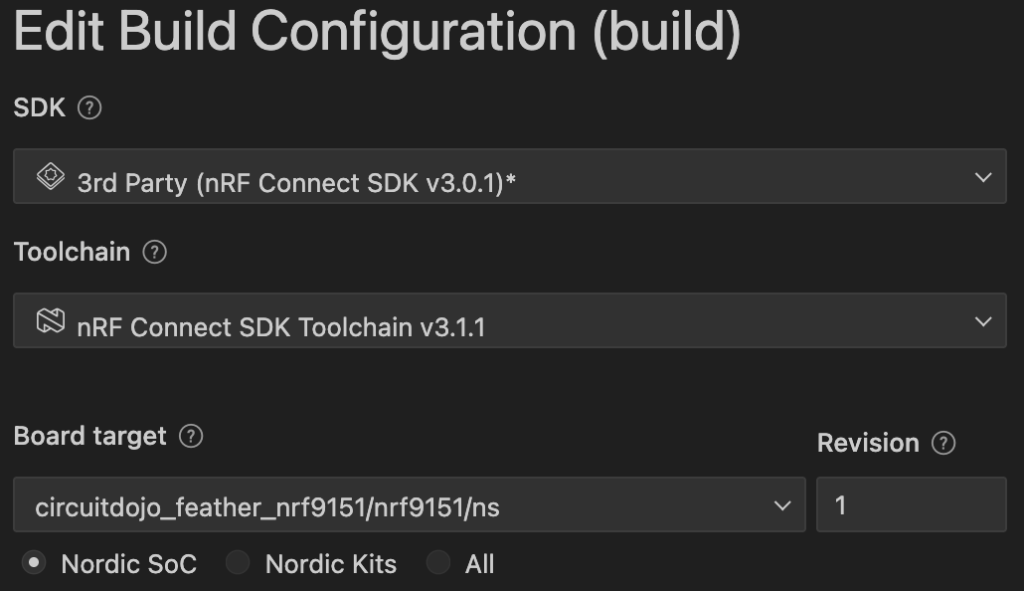

NOTE: I do not use UART and would like to disable it for power savings for final production build. My application works as expected with the exception of power savings due to UART not disabled.
My build file is set as follows:
I am using the default settings in ‘circuitdojo_feather_nrf9151_ns_defconfig’

It appears that the build process is picking up circuitdojo_feather_nrf_9151_defconfig instead of circuitdojo_feather_nrf_9151_ns_defconfig
what am I doing wrong?
