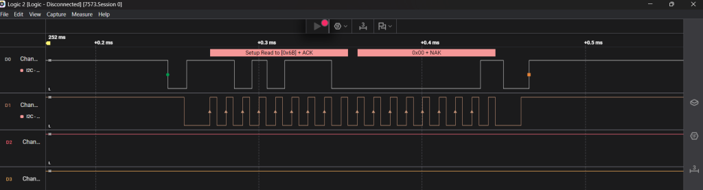

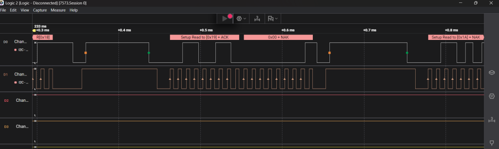

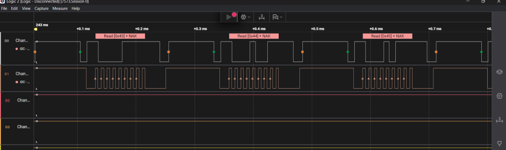

Hi,
I am trying to interface a SHT40 temperature and humidity sensor with feather nrf9151 the sensor sensor is not detecting on i2c pins on header
on the same pin i have checked with logic analyser and getting i2c traffic as you can see the attached images there is ACK for LIS2DH and npm1300 on address 0×19 and 0×6b but not gatting any ACK on address 0×44(SHT40).
