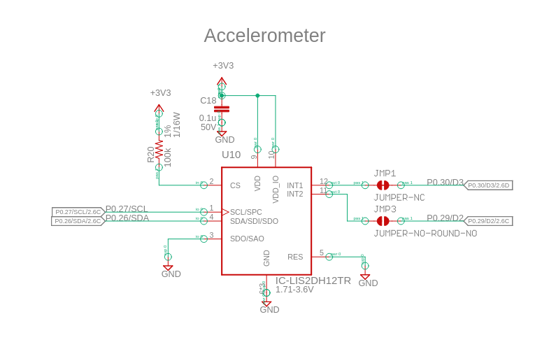

    Both interrupt pins are/can be connected. Here’s a snippet from the schematic:
    INT1 is, by default, connected. INT2 is the opposite. If you need it simply solder the jumper that’s on the bottom of the board. I believe it’s been like this since V3 of the board.

            jaredwolff Hi again🙂 I’ve got the new CircuitDojo feather9160 board and soldered the JUMP3 pad. I have decided that I want to read the accelerometer once every second, which as far I understand, corresponds to the accelerometer sample provided. What confuses me is that the trigger is not getting triggered, and stays in the while loop, see below.

              The schematics shows on page 3 the wiring.
              nRF9160 pin 30 <– JMP 1 — LIS2DH INT 1
              nRF9160 pin 29 <– JMP 3 — LIS2DH INT 2
              The LIS2DH documentation explains, how the events (e.g. “data ready” or “any motion/threshold”) are then mapped/configured to the INT1 or INT2 pins. The driver (I analyzed that some weeks ago) maps these events by default:
              data-ready => INT1
              any-motion => INT2
              With that, “data-ready” is
              LIS2DH INT1 – JMP 1 —> nRF9160 pin 30
              and bindings then explains:
              The INT1 and (optional) INT2 signal connections.
              With that,
              iq-gpios = <&gpio0 29 GPIO_ACTIVE_HIGH>, <&gpio0 30 GPIO_ACTIVE_HIGH>;
              maps pin 29 to the “data ready” event, but physically it’s connected to pin 30.
              iq-gpios = <&gpio0 30 GPIO_ACTIVE_HIGH>, <&gpio0 29 GPIO_ACTIVE_HIGH>;
              maps then the defaults of the LIS2DH driver to the current wiring.
              If you add the “anym-on-int1”, you even don’t need JMP3. Then the LIS2DH reports both, “data-ready” and “any-motion” on INT1, which is wired to PIN30 and all works without modification.

                I think the .overlay file in the sample program should be changed to:
                irq-gpios = <&gpio0 30 GPIO_ACTIVE_HIGH>, <&gpio0 29 GPIO_ACTIVE_HIGH>;
                because according to the schematics for feather V5, INT1 is connected to P0.30 and INT2 is (via jmp3) connected to P0.29
