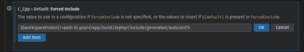

          jhox616 I played around with the include directories and reduced/removed most of the errors:
              "configurations": [
                      "name": "Linux",
                      "includePath": [
                          "${workspaceFolder}/**",
                          "${workspaceFolder}/zephyr/include",
                          "${workspaceFolder}/<path to your>/include",
                          "${workspaceFolder}/<path to your>/app/build/zephyr/include/generated"
                      "defines": [],
                      "compilerPath": "/<path to>/<the toolchain>/.zephyrtools/toolchain/zephyr-sdk-0.15.1/arm-zephyr-eabi/bin//arm-zephyr-eabi-gcc",
                      "cStandard": "c17",
                      "cppStandard": "gnu++17",
                      "intelliSenseMode": "linux-gcc-arm"
              "version": 4
          That’s my .vscode/c_cpp_properties.json file.
          Still doesn’t find the autoconf.h with the CONFIG variables since it’s imported via ninja. I added a forced include to it:
          I’ll keep playing with it and update you if I find any other tips/tricks.

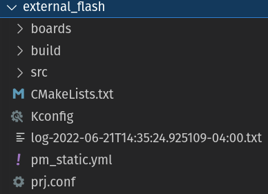

                The log file is saved in the application folder you’re building/using.
                See that log-2022.. file? That’s the one I’m interested in. When you open a serial connection using Zephyr Tools: Serial Monitor it will automatically generate this file. I’d like to see the output of what’s running on your board right now. There should be output since you haven’t been able to load new firmware yet.

                jhox616 NFED on my machine doesn’t have an application folder.
                The app folder that I’m referring to is the application you chose when running Zephyr Tools: Change Project

                  Here is a screenshot of the file-tree:
                  https://pasteboard.co/w5RXO4wDxcFq.png
