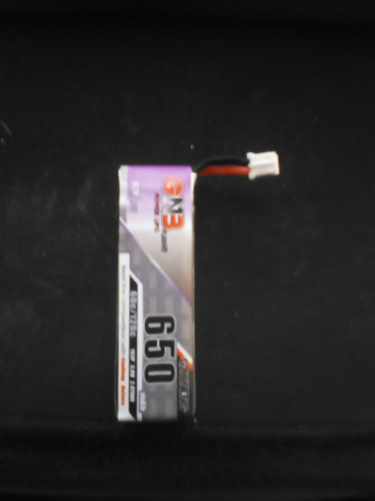

            You need to be careful not to reverse polarities of the battery. Can you share how you made your connections. Pictures would be helpful.
              jaredwolff oh course. It is entirely possible that the polarity was switched. It uses the small JC plug type (i know that that isn’t correct but I hope you know what I’m trying to say) so it is s male/female slotted connection. I will show you the color wires and orientation so you can tell me if the polarity on the battery connector is not oriented the same as the board. Once that is isolated as the issue. I’d be happy to buycanother board and try again. But until I know exactly what went wrong there is no use smoking another $120 board. I really appreciate everything you do: your product, your service, and the extra mile you go in helping the community. Hopefully this can just be a lesson learned and I can continue on in success with your board. It has been very discouraging but I’m hoping in the end it will be worth it.

                    I replied to your email. Here’s the image you provided of your battery cell:
                    See my response copied below. Look carefully of which side is the positive and which side is the negative on that JST connector:
                    Also take a look at this page for example: https://www.adafruit.com/?q=lithium+&sort=BestMatch
                    Look closely at the orientation of black/red. They’re opposite to the battery you used. That’s no bueno and definitely no supported.
                    It’s easy to fix on that battery if you want. You just need something sharp like a pin to remove each wire and then push them into the correct orientation.
