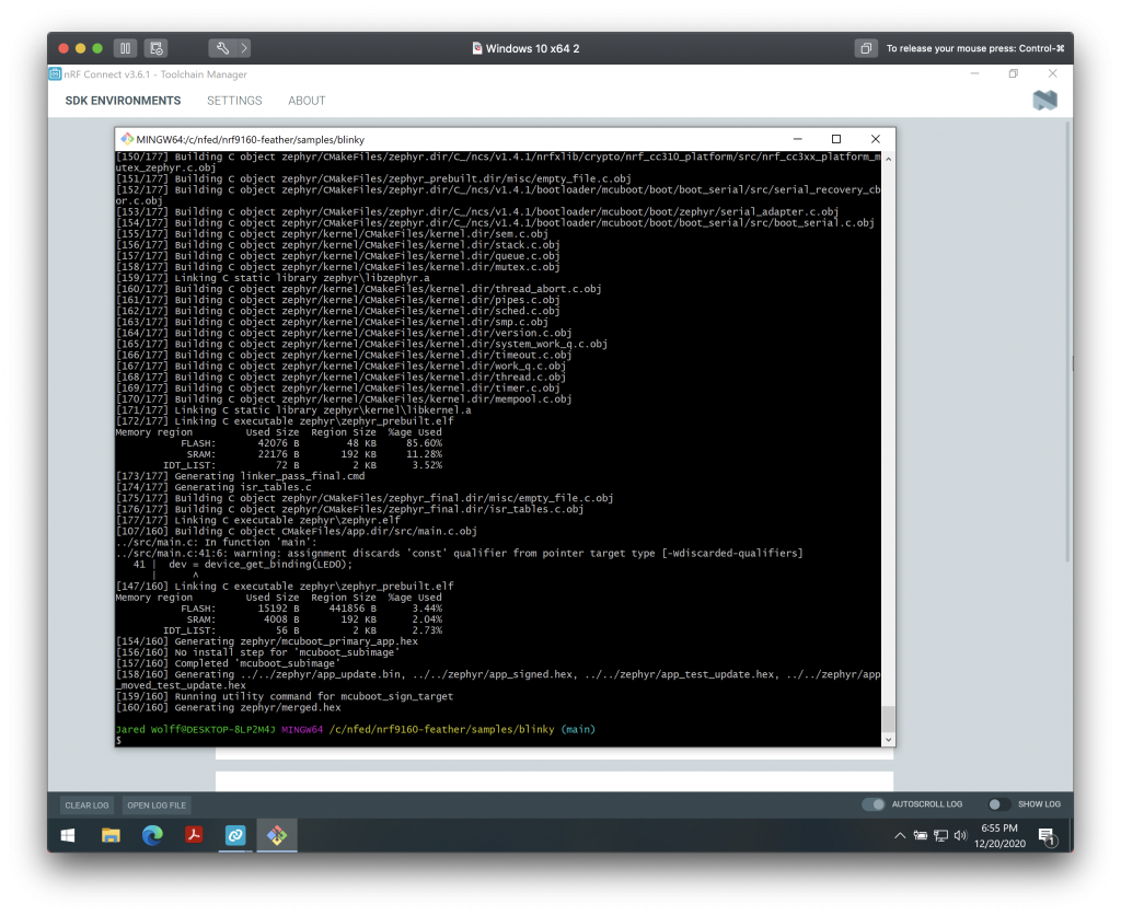

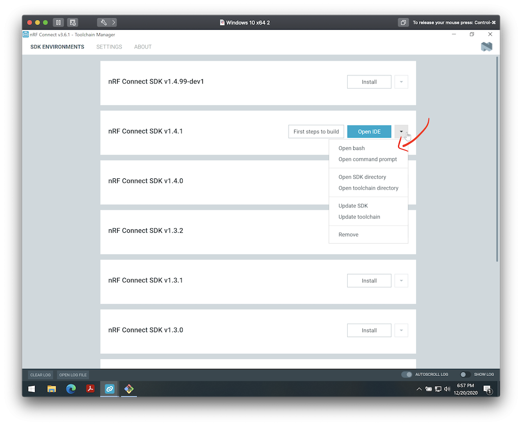

@mikcatta so I spent some time playing around with compiling with the Toolchain Manager and had some success with the NFED repo.
I used v1.4.1 and it work a-ok. Simply open a bash prompt or command prompt. This will pre-load your environment:
You’ll have to copy your nrf9160-feather folder from nfed into whichever nRF Connect SDK you’re using. In my case I put my SDK install in C:\ncs\v1.4.1\
Change directories and then compile as prescribed before: west build -b circuitdojo_feather_nrf9160ns -p

Yes!!!! That compiled ok on my Windows machine, thank you so much for struggling on with this.
