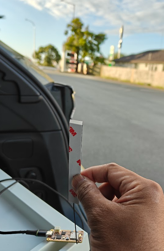

[00:09:15.559,051] <inf> main: Timeout
[00:09:15.559,143] <inf> cloud: Publish path: <my url>/api/device/data
[00:09:15.559,265] <inf> cloud: Payload: {"do_something":true}
[00:09:15.559,326] <inf> cloud: Looking up <my url>
[00:09:16.792,266] <inf> cloud: getaddrinfo() successful.
[00:09:16.792,877] <inf> cloud: Socket created.
[00:09:16.792,907] <inf> cloud: Socket options set.
[00:09:16.792,907] <inf> cloud: Socket TX successful.
[00:09:16.793,182] <inf> cloud: TLS setup complete.
[00:09:18.152,343] <inf> cloud: Connected!
[00:09:18.152,374] <inf> cloud: Free addr info
[00:09:18.152,404] <inf> cloud: Socket setup complete
[00:09:21.151,855] <err> cloud: Unable to send data to cloud. Err: -116
[00:09:21.162,292] <inf> cloud: Data sent to cloud
[00:10:15.559,051] <inf> main: Timeout
[00:10:15.559,143] <inf> cloud: Publish path: <my url>/api/device/data
[00:10:15.559,265] <inf> cloud: Payload: {"do_something":true}
[00:10:15.559,326] <inf> cloud: Looking up <my url>
[00:10:15.568,389] <inf> cloud: getaddrinfo() successful.
[00:10:15.568,664] <inf> cloud: Socket created.
[00:10:15.568,695] <inf> cloud: Socket options set.
[00:10:15.568,725] <inf> cloud: Socket TX successful.
[00:10:15.575,073] <inf> cloud: TLS setup complete.
[00:10:19.129,241] <inf> cloud: Connected!
[00:10:19.129,272] <inf> cloud: Free addr info
[00:10:19.129,302] <inf> cloud: Socket setup complete
[00:10:20.587,158] <inf> cloud: HTTP Status 200
[00:10:20.587,249] <err> cloud: Unable to send data to cloud. Err: -104
[00:10:20.589,202] <inf> cloud: Data sent to cloud
1) I got three successful transmits.
2) It will sometimes succeed in the “connect()” call but fail in the transmission of the data.
3) The last log entry shows “HTTP Status 200” but still failed to transmit the data.
So my main problem now is reliability, are there any APIs in the lte and modem library used in the example that can help me verify the state/status of the connection so that I can realiably say that I have sent the data (and hopefully get a response back to confirm?
