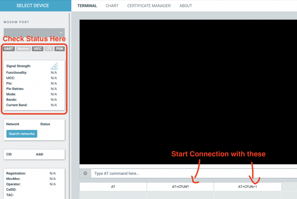

It’s easier to look at the output and let LTE Link Monitor tell you what’s happening. Particularly the status icons (UART, Modem, UICC, LTE, PDN).
Hit the AT+CFUN=1 and then AT+CFUN=? occasionally to see if you connect. the LTE and PDN icons should turn green. The rework should also show up above the Search networks button.

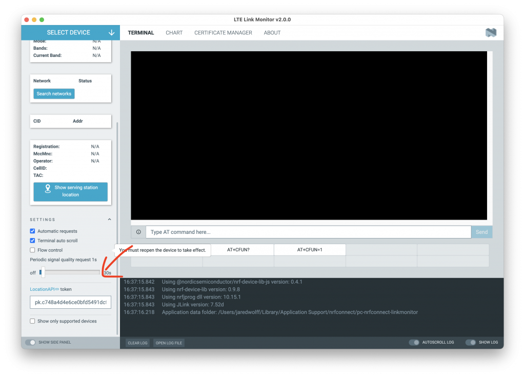

One question. It definitely appears to be working now, communicating through to nRFCloud.com just fine. In LTE Link Monitor, I’m seeing the following in the log, pinging away once per second…

Barliesque One question. It definitely appears to be working now, communicating through to nRFCloud.com just fine. In LTE Link Monitor, I’m seeing the following in the log, pinging away once per second…
Those are the auto-updates. That’s a feature in LTE Link Monitor. You can turn them off here:
